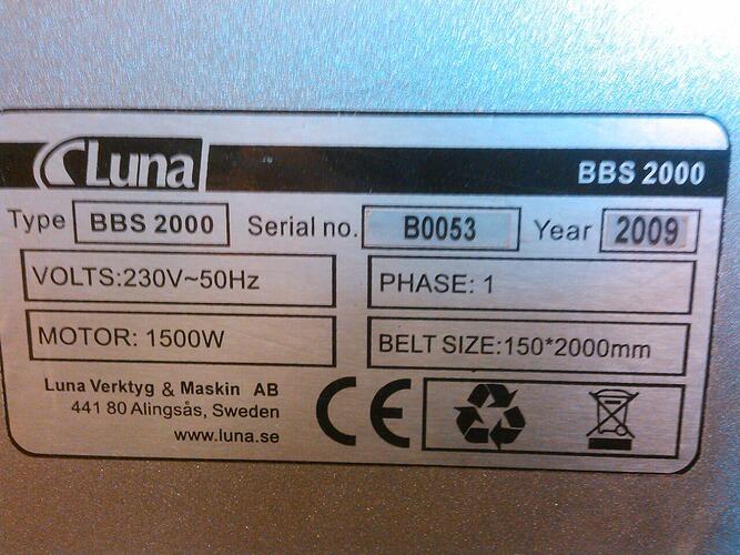

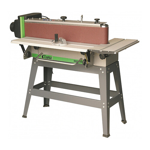

We have a belt sander Luna BBS 2000 at the hacklab without a motor.

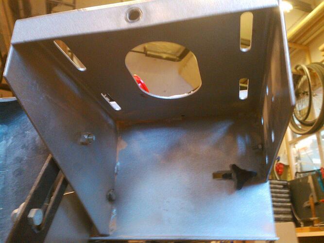

We would need a 1.5kW single or three phase motor to make the sander operational. We do not have the original motor to see details but the motor is some kind of flange mounted from the top. Perhaps we need to make some kind of mounting plate to fit the new motor.
The spacing of the bolts is something rectangular but not square: 100mm*160mm and the slot for axle etc is 70mm.
Helsingissä olisi tämmöinen höyläpenkin painona:
Imgur
Imgur
Vaatinee jonkin verran sovittamista..
