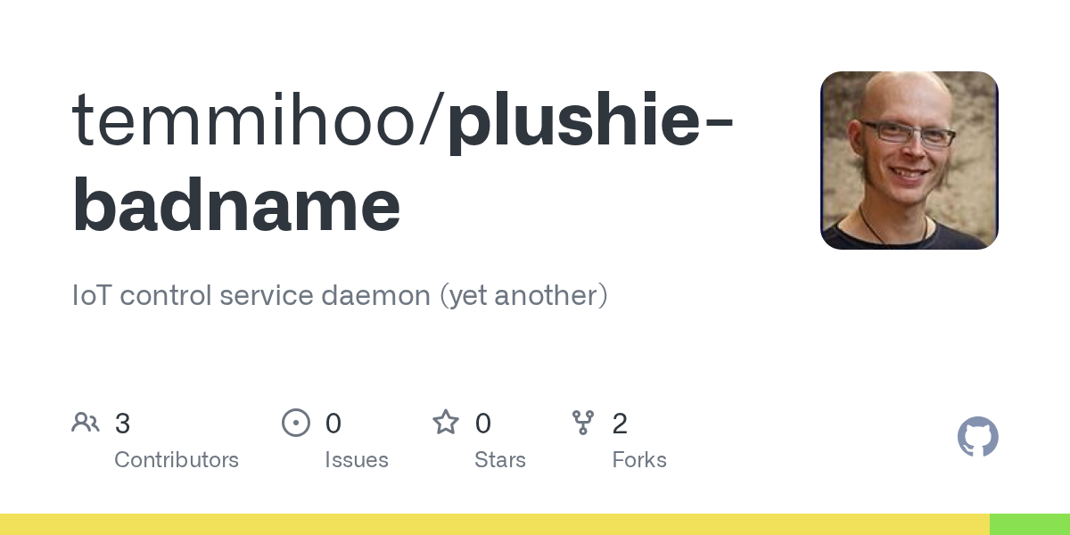

Our ultrafancy IoT controller application, plushie-badname, has new metafeatures:
Gulp is used to run tasks. This is a bit like make but in JS and in general much better. Now it can watch JS files with a linter and watch-running unit tests is just around the corner. This way we can enable the tight dev feedback loop for pure JS as well. In future, Gulp allows us to package the UX side in a browser friendly manner.
Npm can now be used to package, publish and run the software. The most important part of this is a standardized entry point specified in package.json file.
Heroku (or any other PaaS) can run the software largely because of the standard entry point. I made a free Heroku account and we’ll try see how this inspires us to deploy the same software to run on a Raspberry Pi.

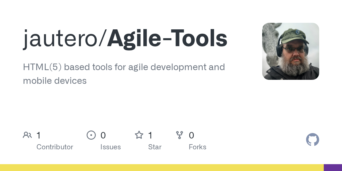

Few years ago when I got first time exited about TDD, I started writing a bunch of agile tools in JavaScript.
One of them was for tracking test-code-refactor cycle:
It runs unit tests and updates state based on current state and result of the unit tests. I was going to present it
and show how to take it into use, but I have been missing couple of last Mondays. I’ll try to be there today.

Our beloved control application could possibly use a proper name but at least we can make it work no matter what.
As I wrote earlier, it is on Heroku as well, even though there’s nothing to run and nothing to connect to yet. https://plushie-badname.herokuapp.com
